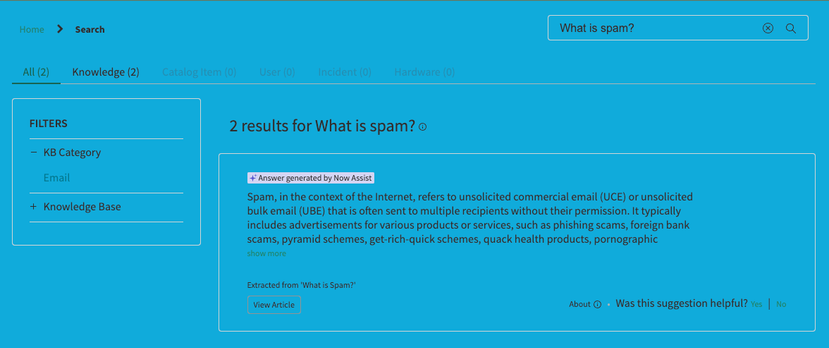

4. Now publish the Search Profile, and it will now display the NowAssist answer in the Genius Results on the Search Results page.
I hope this helps.
I hope this helps.
