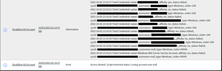

Can u post detailed Log?
Krishna N
@Rahul Priyadars  Please check below log.
some time this credentials are working properly, Please check and help me with this
