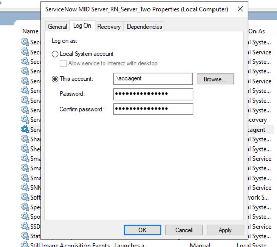

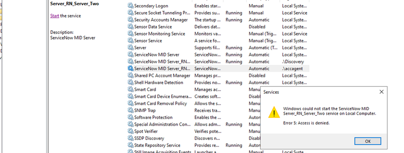

I am getting the below Error message when I change the Log On As user from Local System Account to a New user.
He has Log on as a Service.
In the Wrapper_override, I have mentioned,
wrapper.name = snc_mid_rn_mid
wrapper.displayname=ServiceNow MID Server_RN_Server_Two
Thanks in Advance!
Najmuddin.

Hi @Najmuddin Mohd  check below steps
1. check if it is domain\user account it must have log on as service permission.
2.ensure correct file permission
3.Recheck password and start service.
4.sometime local security or antivirus software can block service to start.

Pratiksha
It happens due to the user either dont have access to the file. Provide the permissions and it should work.

You can set the service to run as "local system account" otherwise if you require that specific local account, it might be missing the correct rights "log on as a service" in your Group Policy/Local Policy. (https://www.se.com/us/en/faqs/FA361304/)
Hello @jonsan09 ,
Thanks for your response.
I have given the user log on as a Service. But it fails, but when I give the User to the Administrator group it works.
I believe it is due to some restriction access.
