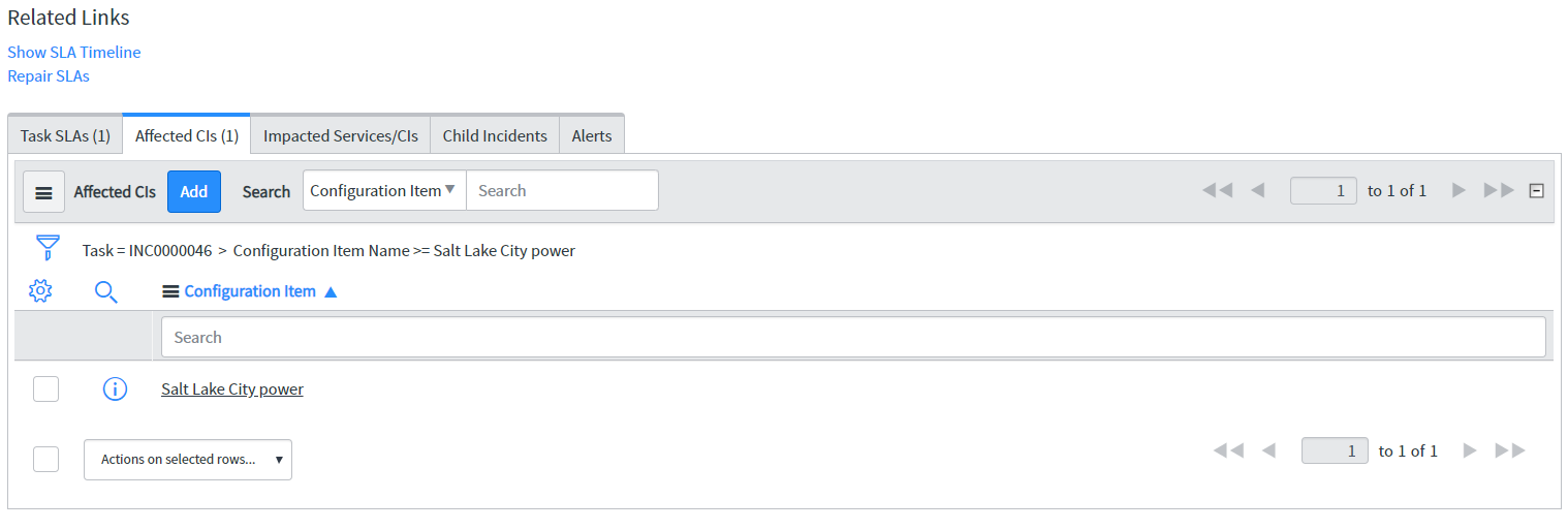

Hi Andrew,
I used POST and it worked for me; I gave the task and ci sys_id in the body
Incident without CI
Incident with CI
Post Method Endpoint: https://instanceName.service-now.com/api/now/table/task_ci
Post Method Body:
{"task":"4b150dd6ef01200099620fa3f82256e7","ci_item":"64a9280d3790200044e0bfc8bcbe5d65"}
