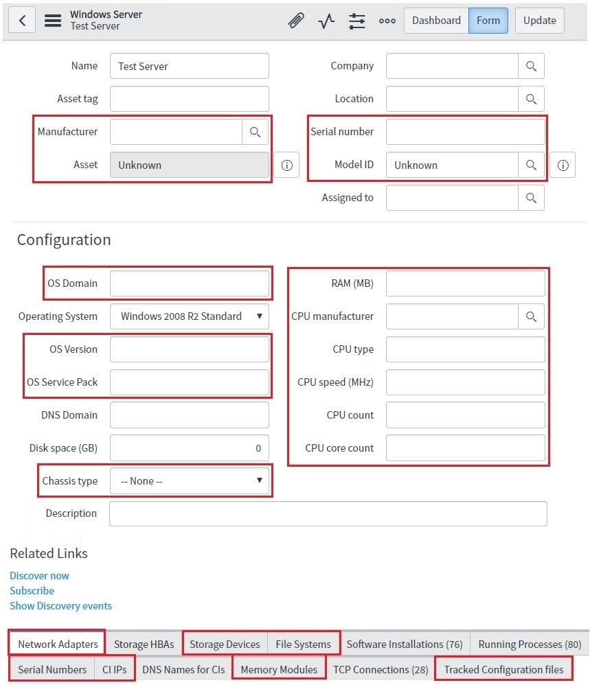

It may NOT be obvious that errors occurred during discovery of the Windows server because:
2) All phases ran and processed (ECC queue TAB):find_real_file.png
3) The pattern completed (Discovery Log TAB):find_real_file.png
4) All of the Windows OS – Servers Pattern steps completed (green icons):find_real_file.png

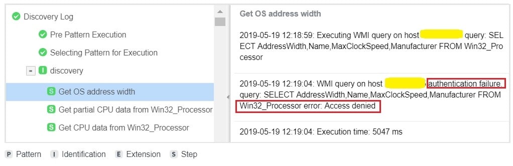

All of the individual steps within discovery completed with green icons.  In this example, the Pattern contains a total of 39 separate step failures (authentication failed/error: Access denied) and all the step icons remained green (normally a pattern step failure has a red icon).  To determine which steps failed requires going individually one by one.  An example of an error (authentication failure/error:  Access denied) is shown for the Get OS address width individual step.find_real_file.png
Many of the attributes and related item data do not get updated as a result of the access denied errors from the Windows OS – Servers pattern:
