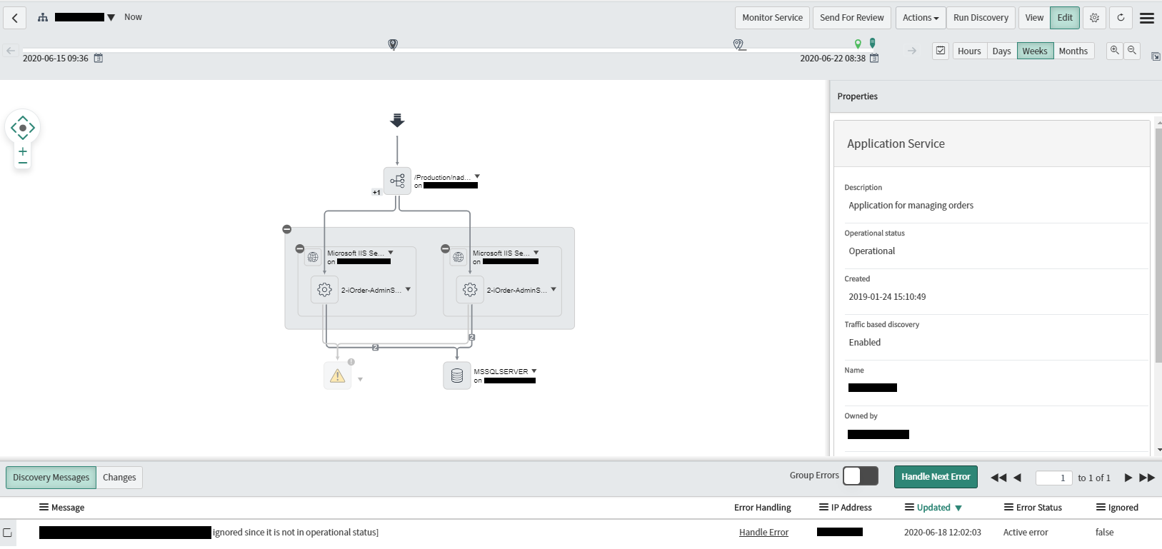

I just left a Major Incident call where I was notified that a process (find.exe "sybase") was running on 2 Windows Servers in a pair, that were initiated by the Elevated Privilege (Domain Admin) account used for Discovery and Service Mapping.
I had been running a Service Map Discovery on the related Application Service earlier this afternoon (active error from 12:02PM CT) and assumed that the Service Mapping had concluded. There were 2 identical processes on each of these 2 servers. I am not referring to the MID Server, but the host machines running a production website. The processes were still running on those servers well into the evening causing 100% CPU usage.

Thanks for your response. Unfortunately when I try to go into the Discovery Log for the Application Service it says no results. I'm not sure what happened to them. From my research into the various CIs on the Service Map, there is nothing related that is running Sybase. We are a Microsoft shop, and as a result have 95% or more of our databases in MS SQL.
The only nodes in this map are the entry point (http), the Load Balancer (F5) that connects to 2 servers running the site and the IIS sites running on them. The last connection is to a MS SQL database. The connection at the bottom left is deprecated and the server is no longer online. I'm not sure why this node is being mapped, other than possibly somewhere in the code of the application it is still pointing to that server.
The find.exe processes were running on the 2 servers in the image that host the IIS site.

I couldn't pinpoint to the location where issue is happening. As you said and from the map I don't see any sybase related patterns executed.
May I know, why in your title it is mentioned sybase? If some sybase related nodes or discovery is happening in your env, as said, there is an initial suspected location was w.r.t sybase related pattern only.
From these patterns from map I no where observe "find" getting executed, its always "findstr" used in these patterns.
