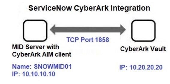

Giovanni,
A more detailed example of the CyberArk logs might be helpful. When troubleshooting, I suggest looking at the logs in this order: 1) APPConsole and then 2) APPAudit.
1) APPConsole
The APPConsole log shows if the CyberArk AIM client is successfully communicating with the CyberArk Vault. Successful communication with the CyberArk Vault generates 3 separate log entries in the APPConsole log file as shown.
[05/07/2020 | 13:09:48] | :: | APPAP032I Main parameters file [main_appprovider.conf.Win64.10.05] was loaded successfully
[05/07/2020 | 13:09:48] | :: | APPAP258I Supported addresses for this provider [10.10.10.10;SNOWMID01;SNOWMID01.lab1.com]
[05/07/2020 | 13:09:48] | :: | APPAP035I Application Password Provider [Prov_SNOWMID01] on machine [10.10.10.10] version [10.5.1.3] is up [AIM Mode] and working with Vault [10.20.20.20]
2) APPAudit
The APPAudit log shows successful password retrievals from the CyberArk Vault. In the example, one credential was successfully retrieved from the CyberArk Vault (Provider Prov_SNOWMID01 has successfully fetched password).
[05/07/2020 | 13:10:22] | :: | APPAU001I Provider Prov_SNOWMID01 has successfully fetched password [safe=ccc,folder=ccc,name=ccc] with query [safe=ccc;folder=ccc;object=ccc] for application [ccc]. Fetch reason: []
Note: Stopping and restarting the CyberArk Application Password Provider service will archive the logs to the C:\Program Files (x86)\CyberArk\ApplicationPasswordProvider\Logs\old directory and start with clean log files.
