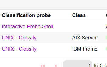

On Image 2, you can find the Classification and Class configuration used for this Quick Discovery.
Please let me know if that setup looks correct or if any changes are required.
