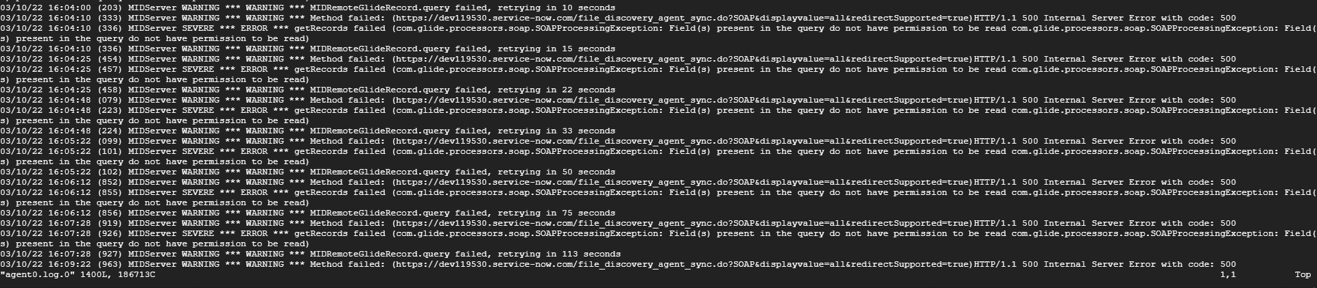

the agent log says this...
I believe it's the account issue or the connection issue to the instance check the account which you used to configure this mid server having the mid_server role.
Also check this KB article for more troubleshooting steps
https://support.servicenow.com/kb?id=kb_article_view&sysparm_article=KB0661756
Vivek
it was a account issue. i create a new midserver user and the problem was resolved.
