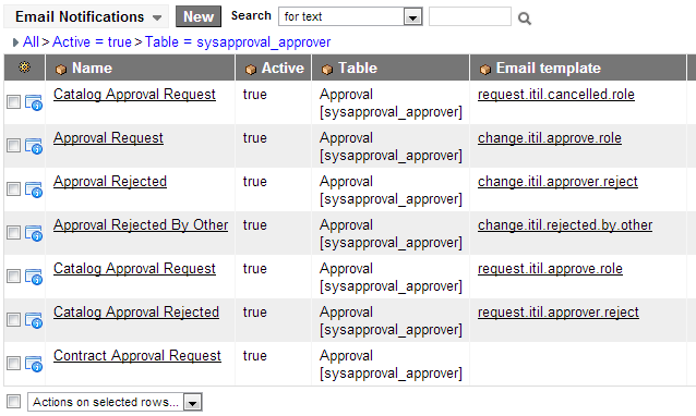

I let you check the https://demo021.service-now.com/sysevent_email_action_list.do?sysparm_query=active%3Dtrue%5Ecollecti... (if you can't access, these notifications)

I did had a look at the notifications and for instance the Approval Rejected goes to the Approver, which is doesn't make sense to my at all by the way....But I would expect to have an option so you can easily manage it to go the the requestor of the Change, request or whatever record.
