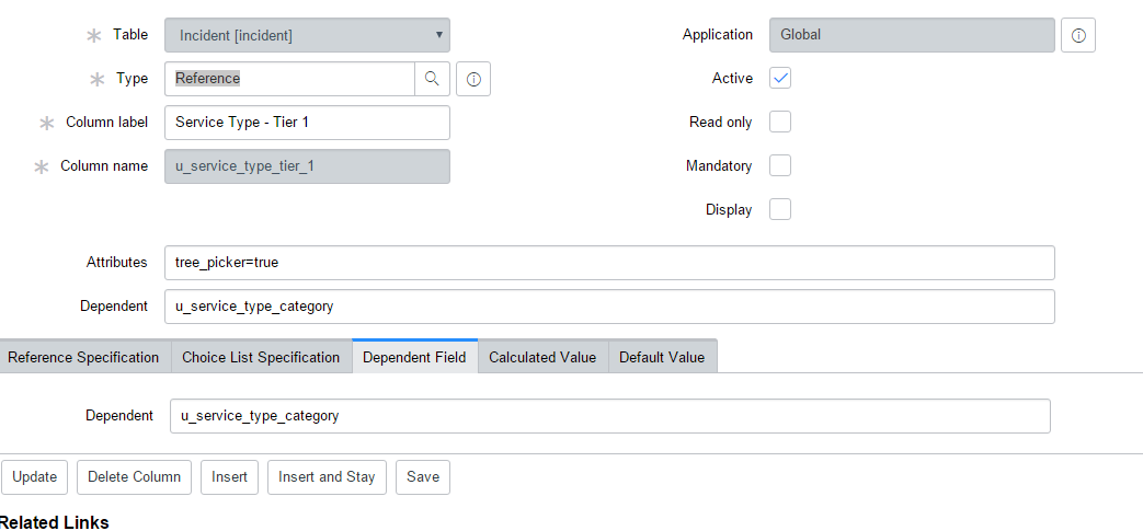

Open you form with category, tier1 and tier2 fields.
On tier 1 Label, right click on the label, and you will get as following :
Click on personalize Dictionary. a new form will open, then you will have as below :
under the dependent tab (second tab), check the 'Use dependent field' and select 'Category'. That means that the 'Tier1' field depends on the category field.
Repeat the same action but now on the Tier 2 Field. For that one, select Tier 1 on dependent field (instead of category)

Kilo Contributor
We are in Fuji. I already implemented Dependent field and a simple reference qualifier . Issue is that when category is empty, I dont want to show anything on tier1. Tier1 should be an empty list when category is null. But instead it shows all the records in Tier 1 when category is empty. That is the issue.
