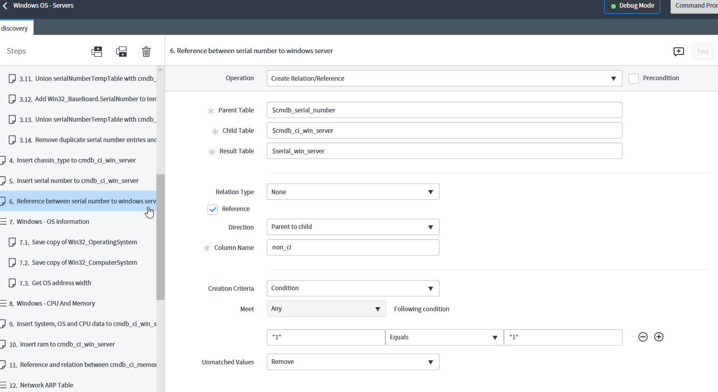

Linux discoveries fail on the Ref/Rel Linux Serial step (4.1.23 in my discovery steps). Image of step configuration is attached below.

I have the an identical step in the windows discovery which completes without issue. An image of the windows step configuration is also attached.
