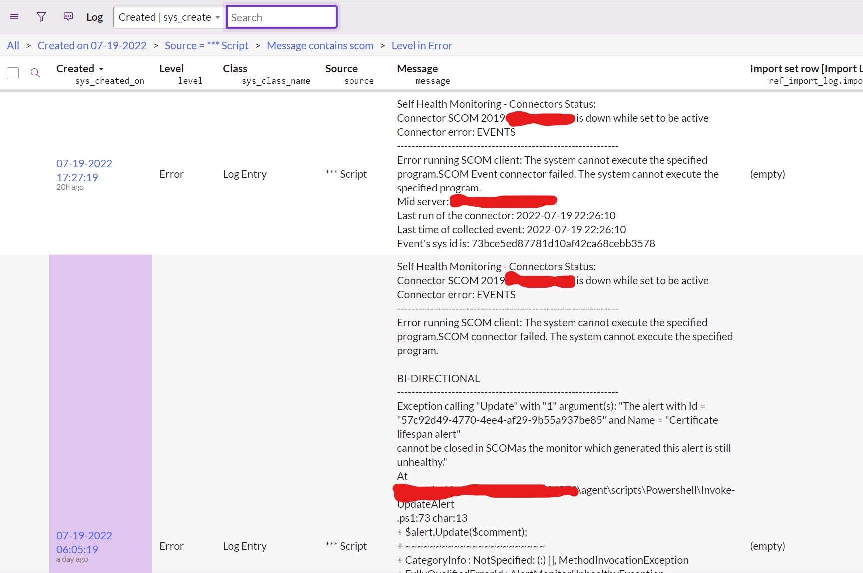

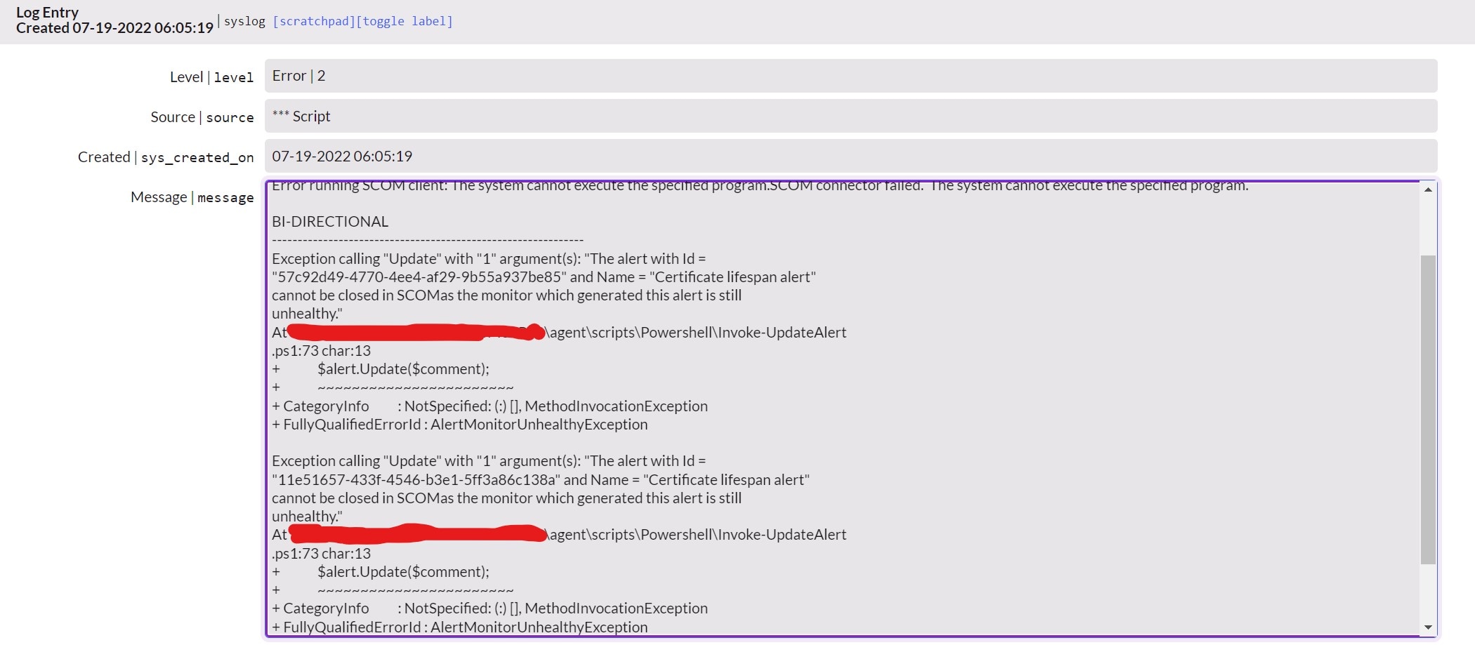

Hi @Rahul Priyadarshy ,
I've got the following error logs:
These were created yesterday:
There were created today:
This agent0.log was grabbed from MID Server that is failing with the connector.
