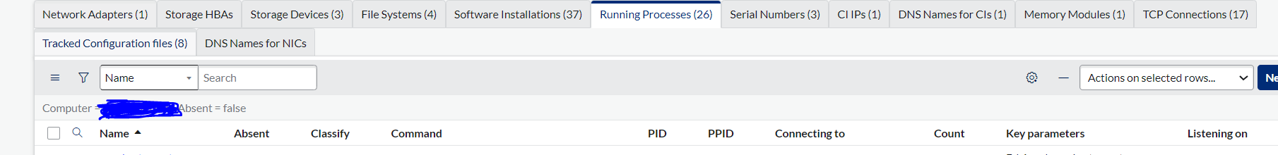

Looks like servicenow discovery couldn't find any active process on that port number. You can verify if the tomcat process is running on the server by reffering to the CI Server Record and scroll down to the Running process tab. Look for PID, Port and name path as shown in the below screenshot. Validate, if the tomcat process is running.
