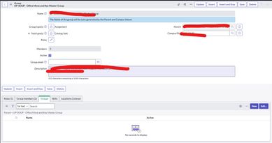

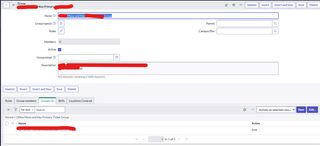

I have this main group that I created a few weeks ago. I then created a second group that inherits from the parent group, broken down by Campus/Site. See two screenshots below.
I want to change the name of the secondary child group, but I can't update the name from there because the parent created the group name.
I drill into the parent and change the name from there.
The child name is not getting updated.

05-16-2025 07:46 AM - edited 05-16-2025 07:46 AM
I found a much easier solution, and will leave this up to help out the next developer.
- Drill into the parent group.
- Click on the Groups tab.
- Change the name directly in the list view.
I'm surprised I got working like this, but it works.
