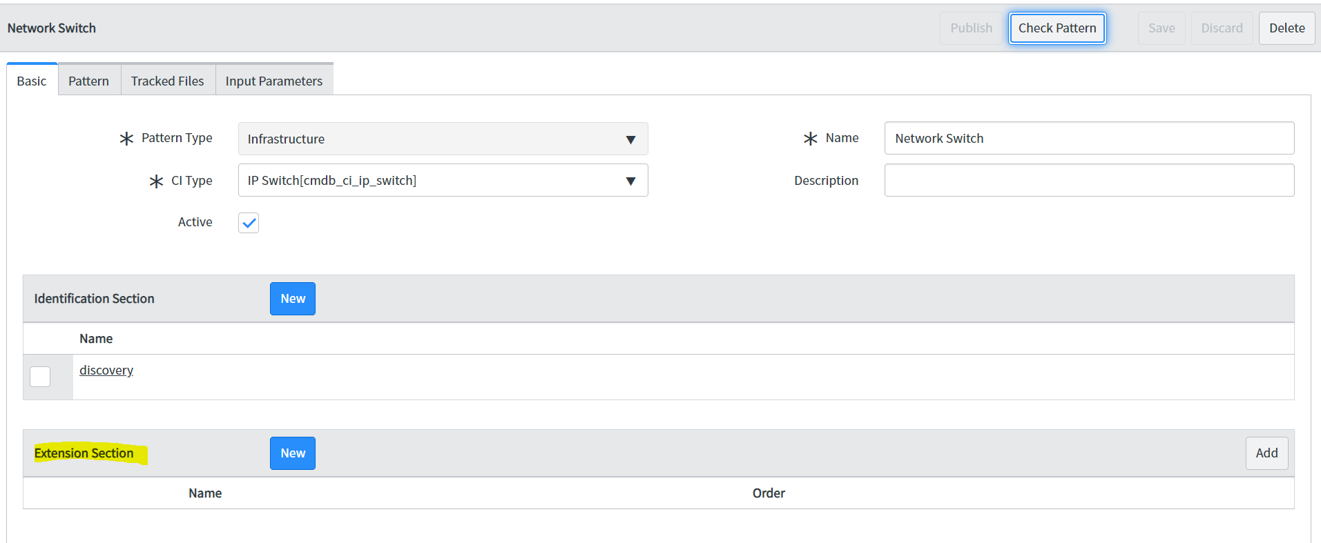

I was confused because I do not see anything in the extension section of the n/w switch pattern to discover WAP's.

Thanks Rahul.
I did check the network switch pattern in our instance (Newyork patch 10). However, No extension found for Cisco WAP's.
After Browsing, I got to know that Cisco WAP pattern extension feature is supported in Newyork patch 10 and later.
