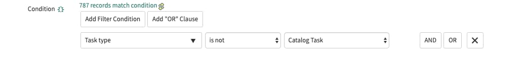

Built this out in my developer instance, and did some debugging.  The task field level write ACLs are providing access to itil.  The joys of ACLS!  So what this means is that for each field that has a task field level ACL, you would need to modify the existing ACL to have the below condition.
Then you need to create the opposite at the task level for the group.  So a field level ACL that does not have any roles, the condition is Task type is Catalog Task, and the script checks the assignment group.
Lots of work for something so simple.
