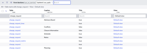

Hello, I was asked to Add a New Required Field to the Change Request Form. I went to my development instance then System UI-Forms-Change Request-I chose the "Default View" because it was the only view that had a "New" button to enable me to add a new "Section Element" (Please see my attachment). After adding the section element titled "communication plan" I saved it. Where do I go to see a preview of it? I am pretty new to development, please respond with easy to understand verbiage. Thank you!!

If you click the hamburger icon on any Change ticket, then Configure, then Form Layout...you can modify the views and sections of the form.
I can change the View Name in the highlighted dropdown and then add a new Section to the form or change the View Name to a totally different view and add additional sections to that view as well. You can add or remove variables to the "Selected" section for each view as well as it will be different for each view.
You can also create a brand new view if you want by clicking New.. at the bottom of the View Name dropdown.
Essentially everything view and section related can be done in the Form Layout screen. This goes for pretty much any table as well.

Hi @DeIvory Gordon ,
You need to add some fields to to the Section "Communication Plan" in order to see it on the form.
Open any change request form and right click on the header, navigate to configure > form layout
Select the section that you created and add some fields to it and save it, ex
Alternatively, you can also navigate to sys_ui_section.LIST from the left navigator and then give the the section name in caption field, open the record, example

Karan, I had been struggling with this for a few days. I saw your reply and was able to make my custom field visible in the specific view I needed. THANK YOU!
