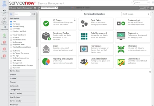

Recently I was researching on a method to make translations easier on ServiceNow instead of tranlating each element on my instance. I thought it was time consuming so I wanted to make that easier with a different approach. I came accross with "https://translate.google.com/manager/website/" where they offer you the tranlation box to add on all the websites. So I managed this by reusing the code provided and added it to a UI Script to make show just next to the lock icon on the main page. Also used part of a code I used to create the Export to Excel button on the report area. Seems to be working fine, I had not tested this on any other SN version but Geneva but please let me know if you find anything wrong or any other issue. I am sharing this with you and am hoping it helps to stimulate your knowledge if there is not anything better out there.

Note: If it does not work, you might need to register(just provide URL where you want to use it) on the URL provided above.
