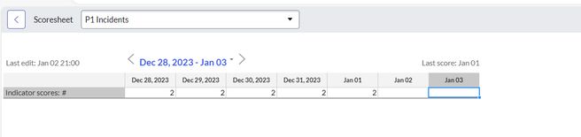

Ok, so I looked through your screenshots and can't see any errors. The reason is, that you had a P1 incident in October and one the day before yesterday. So basic, when you capture data on a daily basis with the condition "created at or after last 6 months" it should show 2.
This is also exactly what your scorecard shows:
Furthermore, if you look at your widget it also shows 2:
Can you please elaborate some further on what you see as an issue?
