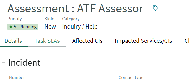

Do you see the highlighting in the detailed view of an Incident?
