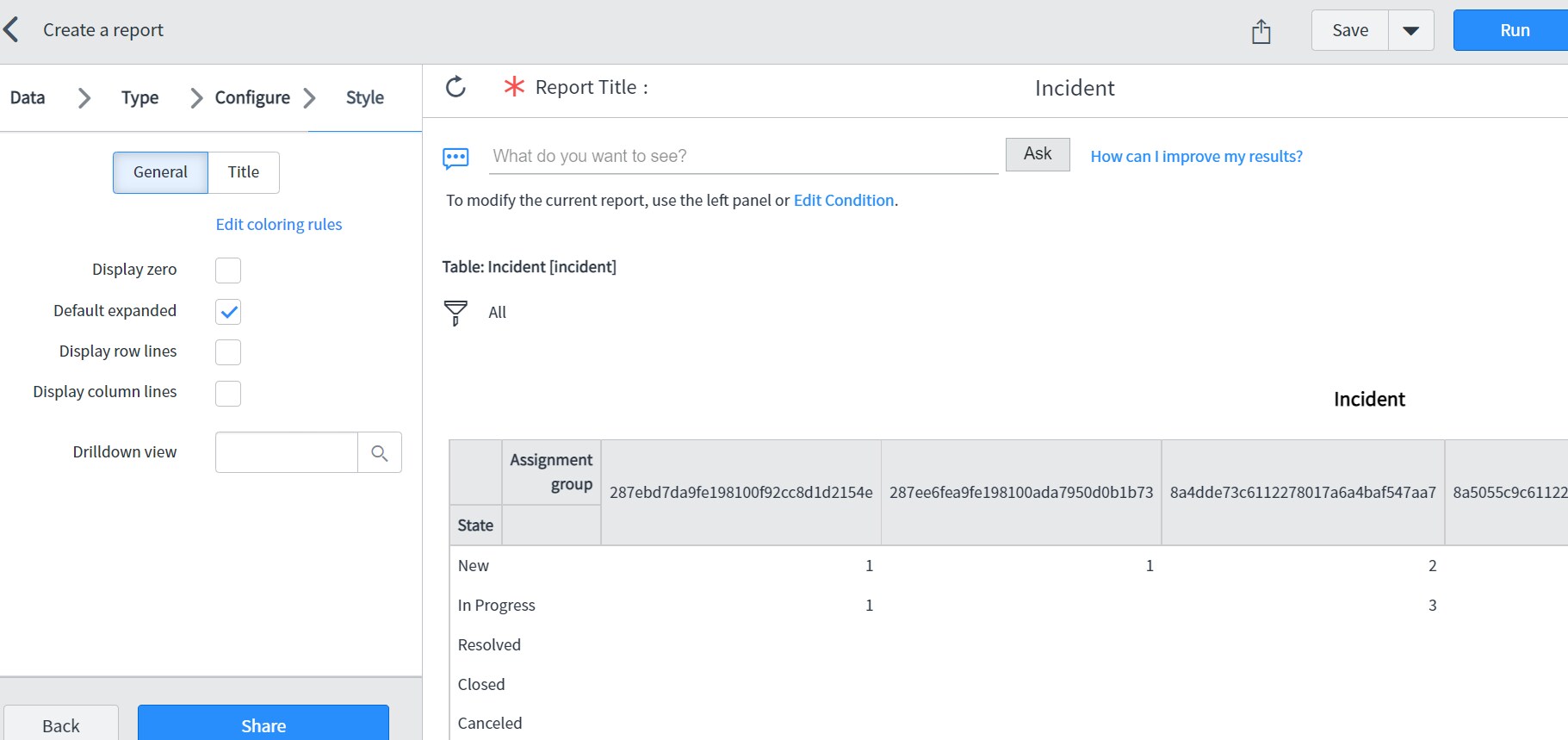

Assignment group is showing sys_id instead of group name
hemanth16
I have created one report when i added the column as assignment group and state as row in assignment group it is showing sys id instead of group name
can anyone suggest?
Thanks in Advance!

The Display value could be incorrect for your table.
1. Go to your Groups table
2. Right-click on any of the columns
3. Select Configure -> Dictionary
4. In the filter add, Display = true
Ideally, you should not be getting any records or there should be a single record which is for the Name field.
In case you get something else, ensure only the Name field has Display checkbox set to true, and other fields have Display = false

On my instance it gave me the name and not the sys_id.
Not sure why the difference, however:
try expanding the Assignment Group, then select the Name field.

Only issue is that this will cause the field you set Display=true on to show up on every drop down and reference lookup that uses that table.  It may have been turned off because someone did not want Number show up on those lists in other forms.  It impacts the entire system, not just your little part of it.
