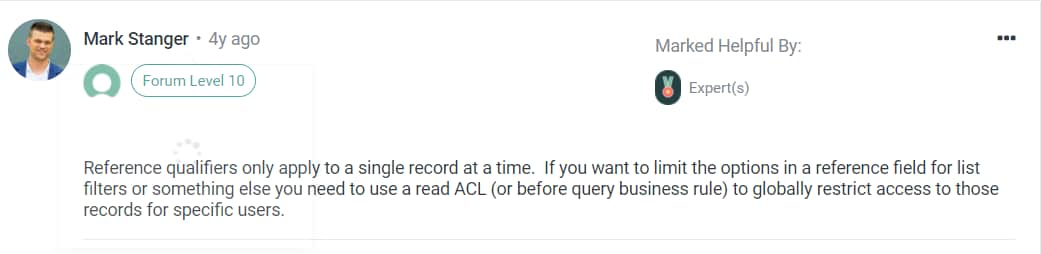

I think I just found the reason why it is not working.
This is not entirely true. If you look closely at my screenshot, I was doing it from a list, not from a particular record. The information you posted is 4 years old and may be obsolete.
