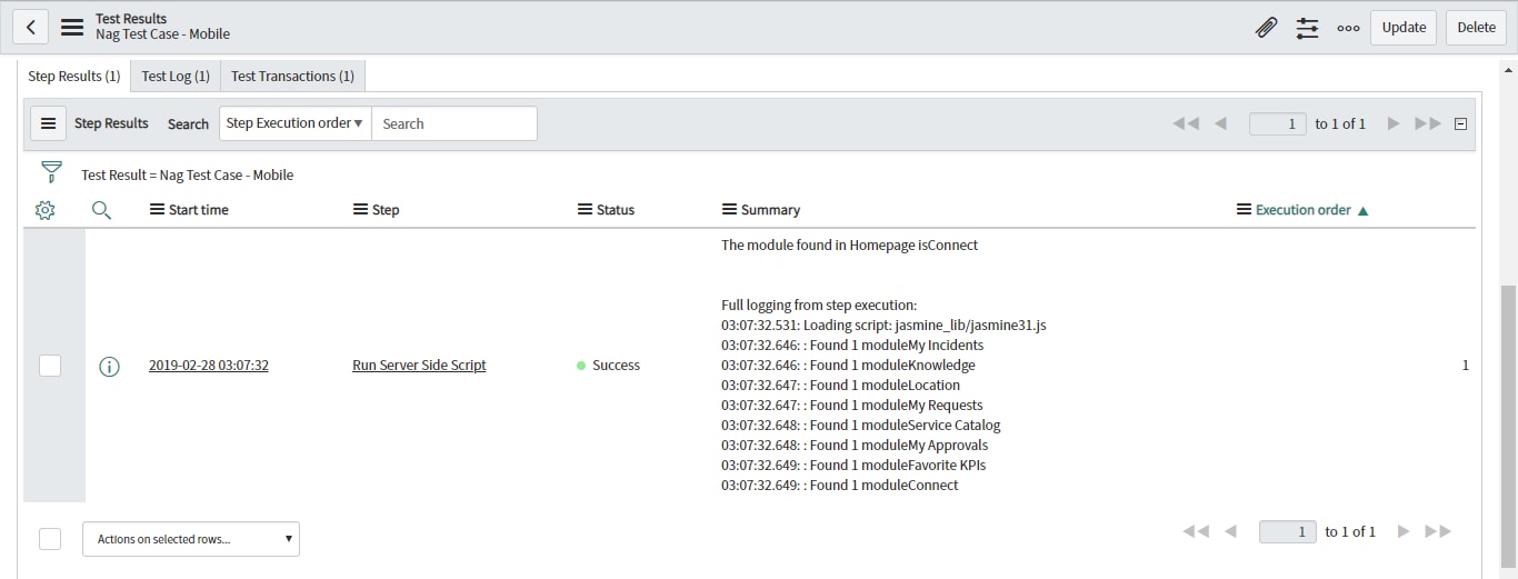

‎02-28-2019 03:25 AM
Hi Nag,
I found a way to verify your requirement - taking an example for Homepages in mobile view. You can use this as sample case and solve your all requirements. I have only used True or Success Case here, you can define failure cases as well.
For Assertion (which is used for checking the expected and actual values) you can use this function:
var testAssertion = {
name: "my test assertion",
shouldbe: "expected value"
value: "actual value",
assertEqual(testAssertion);
You can follow these screenshots for a quick view, code snippet is also provided for easy reference.
1. Test in ATF
2. Test Step - Run Server Side Script
3. Code snippet

Output:
