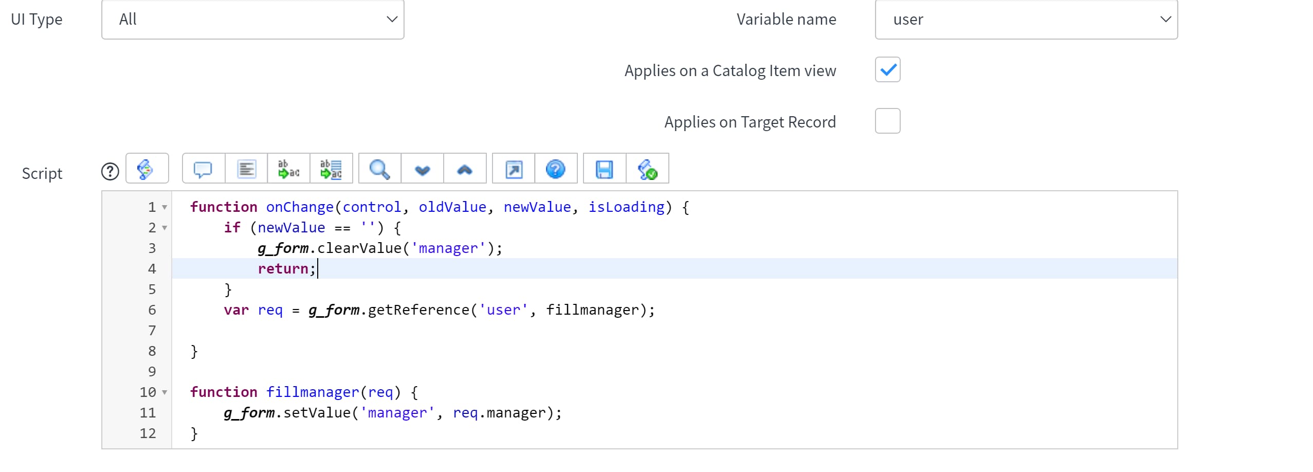

Hi Ankur,
I have used a onChange client script as follow:
if (newValue == '') {
g_form.clearValue('manager');
return;
var req = g_form.getReference('user', fillmanager);
function fillmanager(req) {
g_form.setValue('manager', req.manager);
The variable name in the onChange was user.
Please see the screenshot attached for more clarity
Hi Rohit,
getReference() doesn't work on lookup select box.
Refer below link if you require to use Lookup select box
[SOLVED]: - Dependent variable on Catalog item using Lookup Select Box
OR
Make both the variables as reference type
