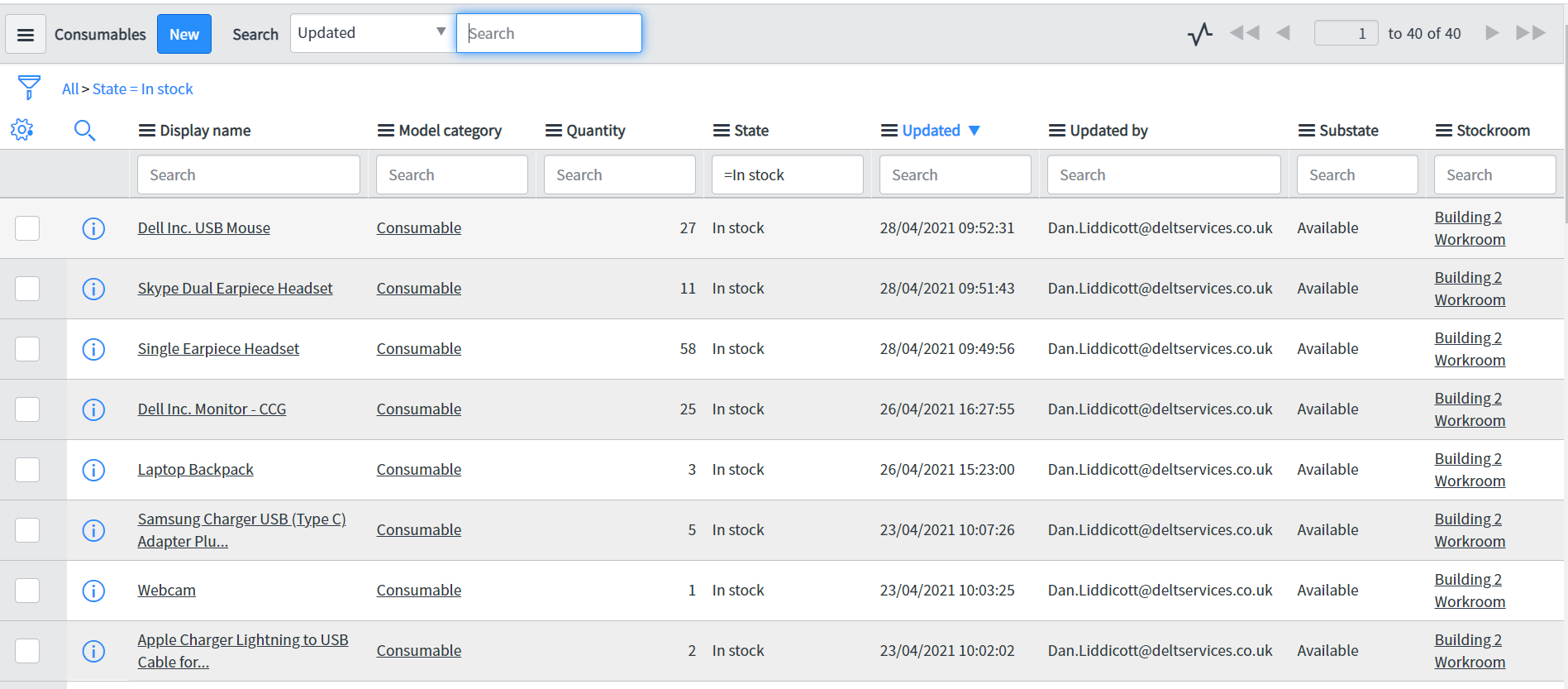

Also Rini, in your first screenshot I see the products in  'alm_consumable' table status is not in instock to consume. products have to be in stock and available to consume.
Thank you for your time.
I have attached 2 screenshots. Actually the item I ordered is Instock, when I order it is not consumed from the respective item rather a new empty record is getting  created.
