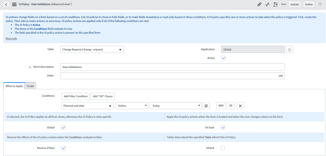

You don't need a Business Rule for your Requirement. Simply an UI Policy on the Client Side would be enough to perform your requirement as explained below:
1) Create A UI Policy on the Change Request Table with Conditions as "Planned End Date Before Today" and use the below Script :
Script:
function onCondition() {
if(g_form.getValue('type') != 'emergency')
alert('Date Cannot be Less Than Current Date');
g_form.clearValue('end_date');
else if(g_form.getValue('type') == 'emergency')
g_form.setMandatory('justification',true);
Please refer the below screen shots on configuring the UI Policy as mentioned above:
So As per the above UI Polciy configured, it will throw an alert and clear out the Field Value i.e. not allowing the User to submit the form. And if the Change Type is Emergency, it will have the same Date Validation as well as it will make the Justification field on the CHange form as Mandatory.
Similarly you can do it for Planned Start Date also.
