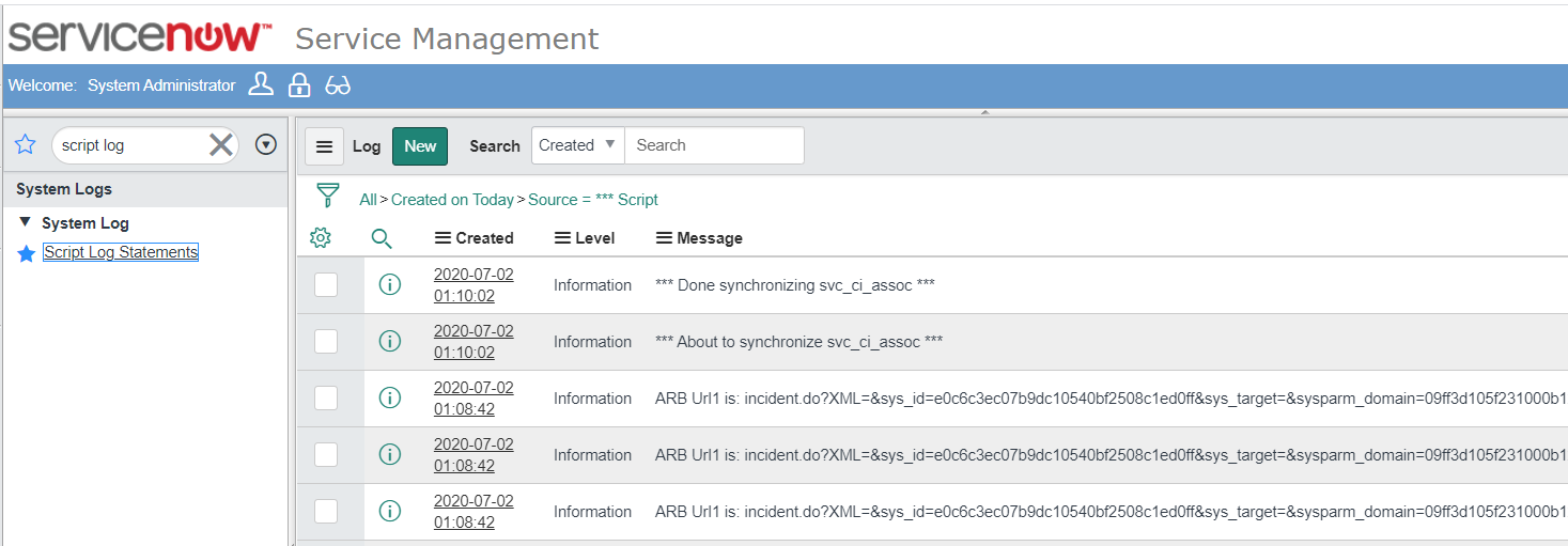

Ankur Bawiskar
gs.info() statements are shown in system logs
Easy way to find that Script log statements in left nav
