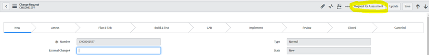

I have an issue with button ''Request for assesment" in CHG form:
it works correct when I have an english set as language but when I switch to german, then when I click on it nothing happens. Do you know what can be a cause?

Hi @Kasia5,
Can you share the details of the UI Action?
It looks like a custom UI Action as I can't find it in my PDI.
If it works in English, it's highly likely that there is a script in the UI Action that is using the display value of a field.
For example, the script might check if the display value of the 'State' is 'New'.
If so, this won't work in different languages as the display value will vary per language.
