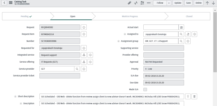

I have added it, but not showing up in the panel ( ON HOLD option ) here below screen
I have it added in the list, but not showing in the above top panel . How to display that in the top panel?
Srinivas.
Right click on header from => configure=>form layout=>drag the state field from Available to Selected=> save it.
