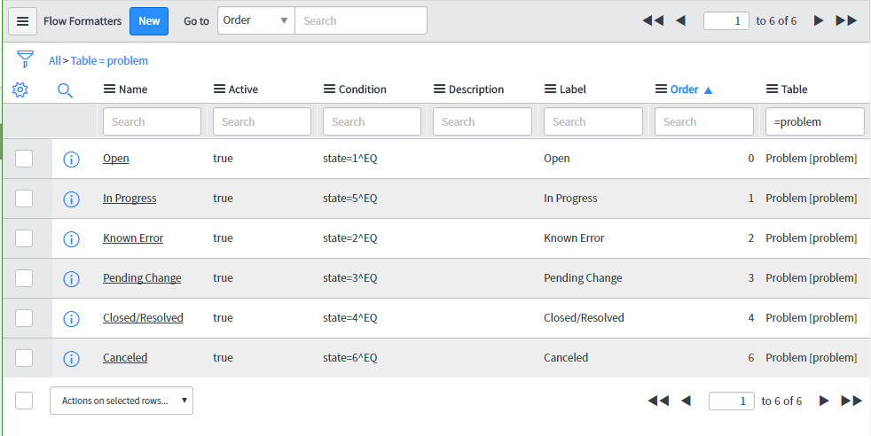

What I mean is I need to make sure On-Hold placed near the Blue arrow , which cannot be dragged from available to selected.
Srinivas.
This is done via the flow formatter. You will have to open the table sys_process_flow.list
From here look for the the table that you want the step added to.
Then create a new flow formatter with the right name, label, order and condition.
The ones you have already in place should help you figure out what to input.
For the above requirement....In navigation bar type process flow=>Click on it=>Show match the required table=>click on New=>fill all the details(Name, Label and In order field you have to mention the number i.e., after which state you have to display this state...For Example: If you want to display this state is after open state then, suppose if open state order is 2 then you have to mention the OnHold state order as 3) and in condition you have to mention that State is OnHold=>submit.
How to show matching the table. Please see the below screen shot for your reference.

Thanks for the information. I am able to add On Hold on the TOP panel of service request as per your suggestion.
Now I am trying to attach the SLA and will update you once done
