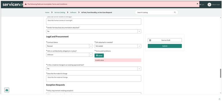

I need to submit a Catalog Item during a test, but there is a mandatory attachment field.
The issue is that when using "Set Variable Values" the input appears as a String/Single Line Text field, so I can't mock a generic image (for example) which would be sufficient, since the field itself isn't the focus of the test, just a requirement for submission.
Even using a "File Attachment" parameter doesn't seem to work. Does anyone know a workaround for this to submit the form via ATF?
It is worth mentioning that I have already tried using a sys_attachment sys_id in this input. I also tried using a different "Add Attachments" test step, but it only works for that OOB field at the bottom of the form, not for custom variables.

The solution that worked for me was using the sys_id of a sys_attachment record directly in the string input generated by the attachment field, as suggested.
However, the important detail is that the "Table name" column is empty; presumably, if the test were performed by a user with access to that specific table or an admin role, this wouldn't be an issue.

Unfortunately, it still hasn't solved my problem—even after querying `sys_attachment` for a valid record and adding that ID to the input. I also can't use that return value with a dynamic parameter.
The result is the same as mocking a sys_id directly in the input without a prior query: Invalid value.

it did work for me
Steps: I gave sysId of any 1 sys_attachment record as input
Output: File attached to variable
