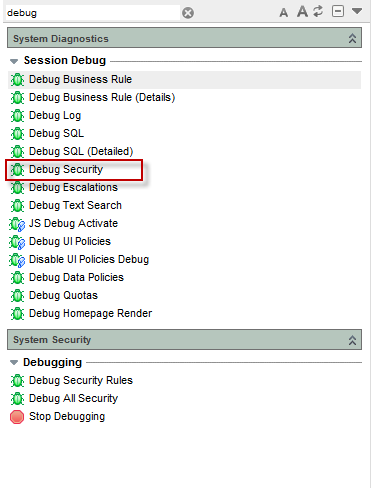

Hi Anthony,
You can enable debugging by clicking on the link shown below.
