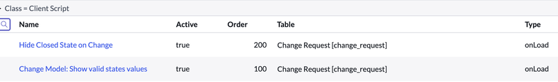

Ok,  I found why.
There is another client script that is showing the next possible State values,  so you need to make sure your script has an Order higher that this one to be executed after this one.
I just tested Order of 200 and it works fine.

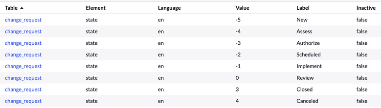

The internal value for the change_request.state of "Review" is 0.

I've also attached the change request state values

Hi JP,
I set the original script to inactive.  Created a new one and the behavior is the same...
itil users can still see the closed state...
