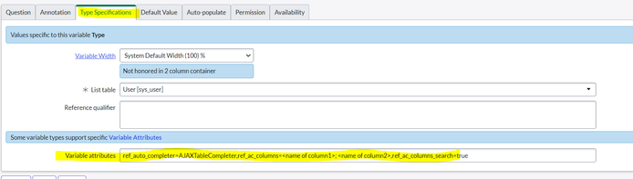

Hello @Clement Dos San
You can add Variable attributes to list collector
ref_auto_completer=AJAXTableCompleter,ref_ac_columns=<name of column1>; <name of column2>,ref_ac_columns_search=true
<name of column1> => put column name you want to display in list collector

09-11-2023 05:00 AM - edited 09-11-2023 05:02 AM
@Vishal Birajdar I saw an dozen of times this solution with this attribute but it does not work with list collectors.
