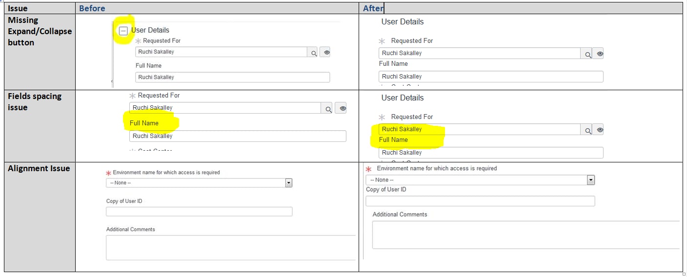

I was facing the similar issue in my instance on helsinki. I had it resolved as adding js_includes_catalog_v2 to catalog UI Page as mentioned below. This might help you as well.
In the UI Page "com.glideapp.servicecatalog_cat_item_guide_view" add a css <g:requires name="styles/js_includes_catalog_v2.cssx" includes="true" />
Results:
Please mark this reply as correct answer if this helps!!
