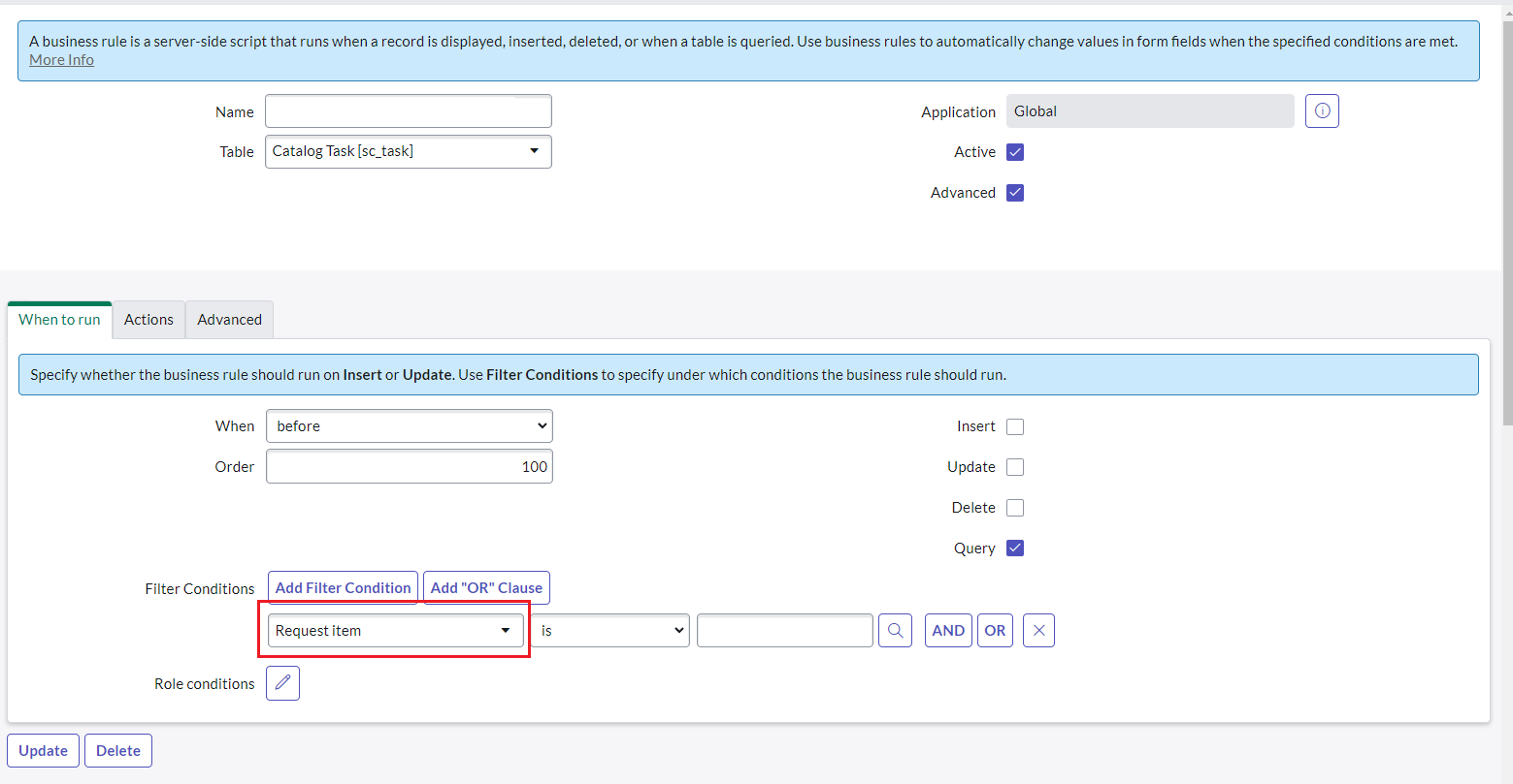

Hello, I can't find the reference table in filter condition of business rule. I'm trying to find the Request item.item but it's not available. What I'm trying to do is to run this business rule only for specific catalog item.

Select request item. Then click the dropdown once again and go to the bottom. There you will see "Show related fields" - click it. Now open the drop down once again and you will have the reference fields in the Request item table.

07-27-2022 11:50 PM
should be simple enough.
If you are facing any challenge then use this in advanced condition
current.request_item.cat_item.name == 'Your Item Name Here'

What are you trying to accomplish? Do you really need a Query BR on 1 specific catalog item? Seems like heavy functionality for just one item.

What I wanna do is to apply a business rule to sc_task table but only on specific catalog item
