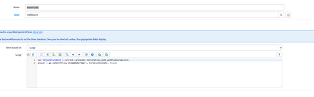

So I've added the timer activity to my workflow:
And this is where I've added the script:
In testing I've set the termination date to 01/05/2023 (see below) as a test but the task is still being created, I was hoping that this would only get created when the termination date was reached, or have I misunderstood.
What am I missing?

04-28-2023 07:28 AM
did you try to add gs.info() and check what came in log for the date?
04-28-2023 07:43 AM - edited 04-28-2023 07:50 AM
I did not no, do I need to add this to the end of the script and then this would be recorded in the system logs?
Kind regards,
Alex
04-28-2023 07:56 AM
something like this
var terminationDate = current.variables.termination_date.getDisplayValue();
gs.info("Termination Date" + terminationDate);
answer = gs.dateDiff(new GlideDateTime(), terminationDate, true);
04-28-2023 08:20 AM
so I can see that yes the termination date is being pulled through
