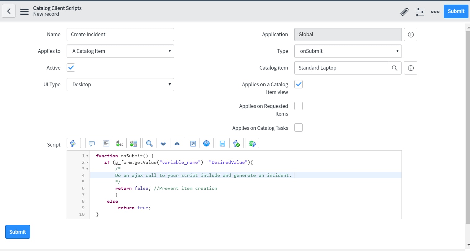

As very well explained by Ashutosh record producer should be used for creating incidents. But still if your requirement is such that you must create either an incident or a request using the same item; you can make use of on-submit client script that will abort creation of SR, create an incident and maybe redirect to the newly created incident record.

Use this approach. I will suggest you use script include for generating incidents.
