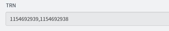

I have a requirement to take values from the task variables and insert records in a custom table.
- i.e there is a variable in the catalog task table 'transfer number' which will have comma separated values 1234567890,34567890,..
- once the task is closed need to add a run script in the workflow to create records in the custom table for each value added in the above variable. If the 'Transfer number' contains 2 values then 2 records need to be created in custom table.
- Have configured the below script but i am stuck and not able to proceed can anyone suggest the solution.

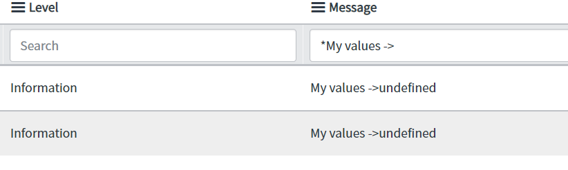

‎02-10-2022 07:01 AM
it means you are using incorrect variable name
use this directly; no need to query RITM table
var trnValArr = current.variables.trn.toString().split(',');
gs.info("My values ->" + trnValArr); // what came here
for(var i in trnValArr){
gs.info("inside of for loop");
var gr = new GlideRecord('u_transfer_order');
gr.initialize();
gr.u_trn = trnValArr[i];
gr.insert();

‎02-11-2022 02:24 AM
Hi Ankur,
Thank you, the above code worked.
