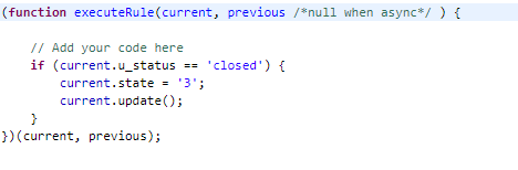

Below is the after update business rule to set state as close complete when status is closed

Hello Sindhu,
As it is not recommended to use current.update() in after BR on table. Could you please change the After BR to Before BR and use the below code:
if (current.u_status == "closed") {
current.state = 3;
current.active = false;
