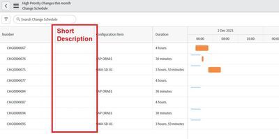

I wondered if anyone could help me add a column to the OOB Change Schedule? It's a great tool to visualise the calendar but would be much more useful if the short description was presented in the main columns instead of having to click on each bar to find out what the task is. Below is what I'm aiming to do.
I've been circling around this for months and have searched the community many times. I found a solution below, and have made the three suggested updates, but it has made no difference for me ☹️.
Hopefully there's a genius out there who can tell me what I've missed!
