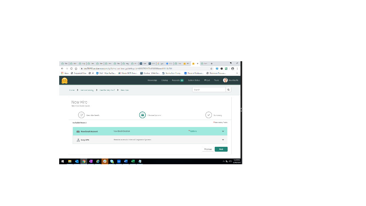

Hello All,
Is there any way we can disable the color "Green" in the image attached when hovered on to the catalog item in the Order Guide on Portal.
Thanks!

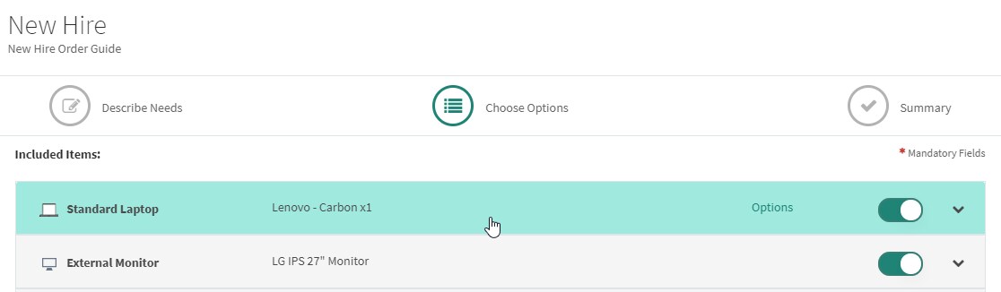

So simply paste that in there and save. Then...when you go back to your order guide to check it out, it'll look like this:
Instead of:
So the line that really controls all this is:
&:hover {
      background-color: transparent;
So if you don't like transparent, which is what I went with as it's not as "loud" as that green, you can change that to various other colors, etc. Personally, the transparent is at least a very light touch of color to just interact with the mouse cursor.
