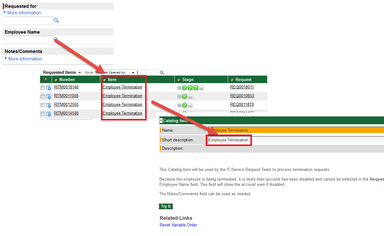

What I am trying to do is set the RITM short description on submit from a variable on the previous form.
I want the RITM to be created and the Short Description to say the the Catalog Item Name + the Variable field value... so this maybe?
