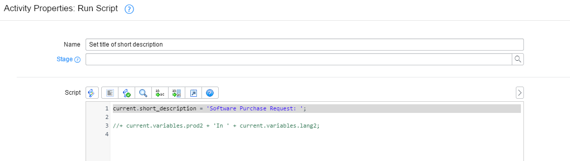

Does this still work? I haven't had any luck with the run script in the workflow.
I commented out the additional variables so I can start simple for troubleshooting.
Brad Tilton
That should work unless you have some sort of business rule on the sc_req_item table changing it back.
Hmm, even if i leave the   description blank   on the item itself it doesn't seem to take. I'll have to see, is it that way OOB?
