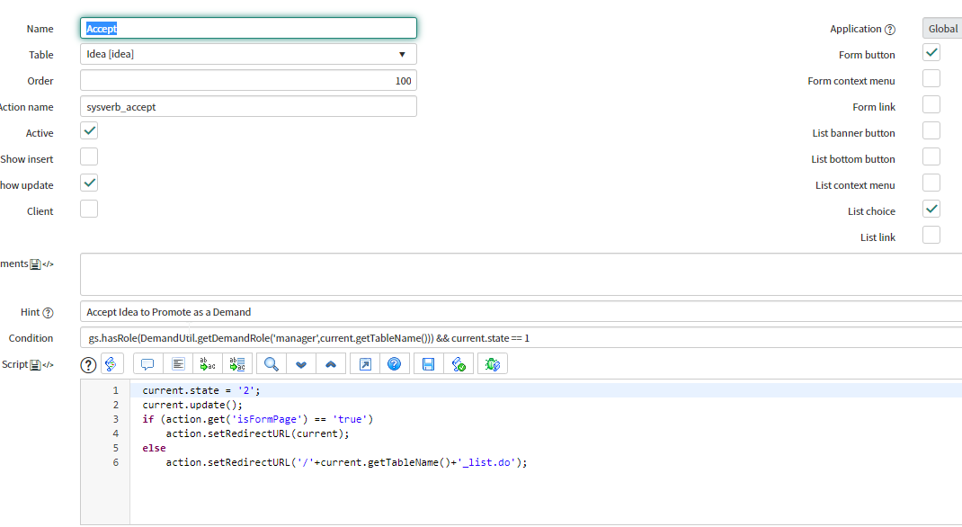

Hi MGR,
In that case I would recommend a deeper investigation to solve the issue instead of simply creating a customization to do something that is coming OOB.
Question: how are you creating ideas? Through the idea portal?
From what I saw the "Accept" UI Action is setting the idea state to Accepted (value 2):
Then, when the idea is accepted, there is a business rule kicking in to create the demand out of the idea:
Can you check if you have this Business Rule active?
Or if you are using the state "Accepted" in the idea? If not, the business rule will not be executed.
Please let me know if this helps!
