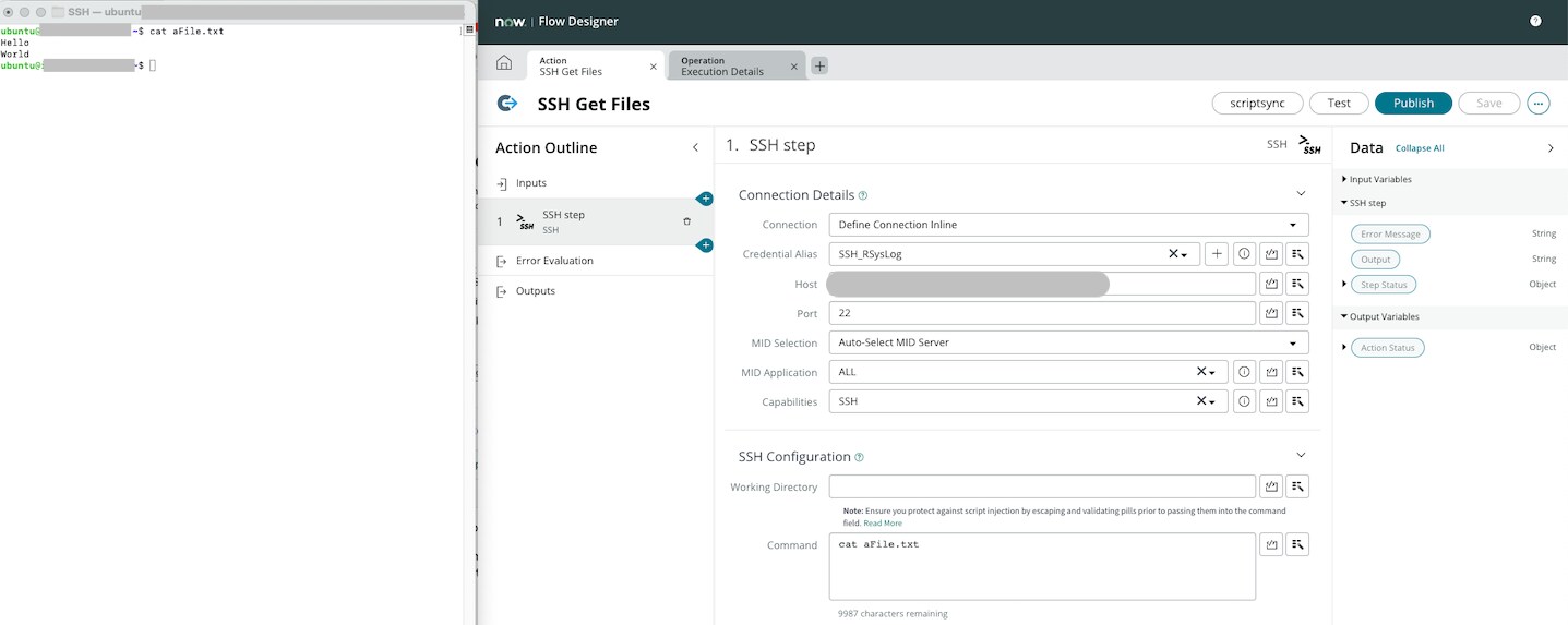

SSH as a protocol is available in Integration Hub Professional / Automation Engine Professional.
Once you have that, along with credentials for the connection, you initiate the connection, traverse to the folder and parse the files.
Left - Terminal SSH connection to client and a list of a file content.
Right - SSH step connecting.
Bottom, result from SSH step test showing contents of text file.

‎08-16-2022 06:35 AM

Thank you for your input, requirement has changed a little bit, we need to retrieve the .csv file from the mainframe system through SSH connection established. till now we have been able to set up the connection and the credentials has been validated. can you please let me know the script to retrieve the csv file from the mainframe system please?
I am assuming in the above screenshot, there has to be a step for script(to retrieve the file) and then SSH step.
let me know if i am going in a wrong direction.
