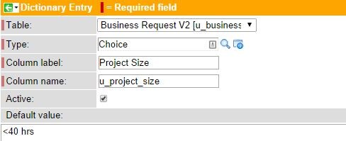

Hello Mark, I am currently facing the same issue. I was wondering if you could guide me towards the right direction.
So,we migrated a custom table and it's fields onto our test instance, the dictionary entries have been inserted correctly however the column label on the dictionary record is empty even though we have a related sys_documentation record.
We observed a couple of issues with regards to this.
  1. When we update the label record on the sys_documentation table for the dictionary record, the record's column label gets updated with the label momentarily and then blanks out.
  2. Moving xmls of the dictionary record doesn't register the update as well.
  3. Even if we manually update the record's label , it doesn't save it.
  4. Lastly, we deleted the column on the dev instance and recreated a new dictionary record with the column name and moved the update, it doesn't register as it is essentially the same record.
So, the work around to this would be to recreate new fields with different column names and move those updates.
Could you possibly help in understanding this issue we're facing?
Urmilla
You are in a pickle!!
Last time i faced such issue it was long back(in Dublin i think) and the only way i could get past is creating new Dictionaries, new name, name cannot be repeated as for some reason when i was creating new dictionary with the same name it was taking back old record and was still not going through fine.
Like the point 4 you mentioned, even when you delete a column and create a new one, its just not ready to forget the old one.
-Anurag
