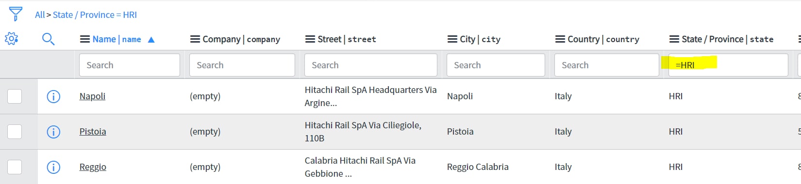

Due to certain requirements, we're not using the country field on the location table. The value selected by the user in the country field is equivalent to value in state field in the location table.
I am able to return the sys_id's in the logs but the same result is not getting applicable on location field.
