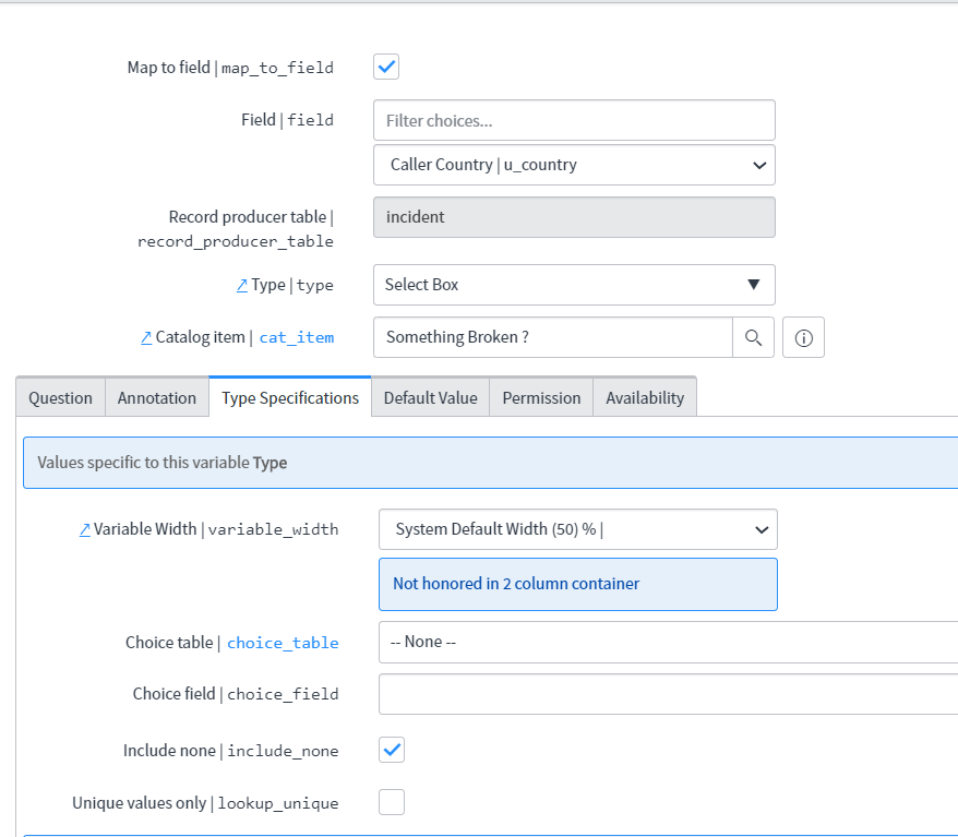

‎01-03-2021 01:13 AM
is your Country variable a lookup select box with reference?
what is the Lookup value field for this variable?
That would help you determine the query
